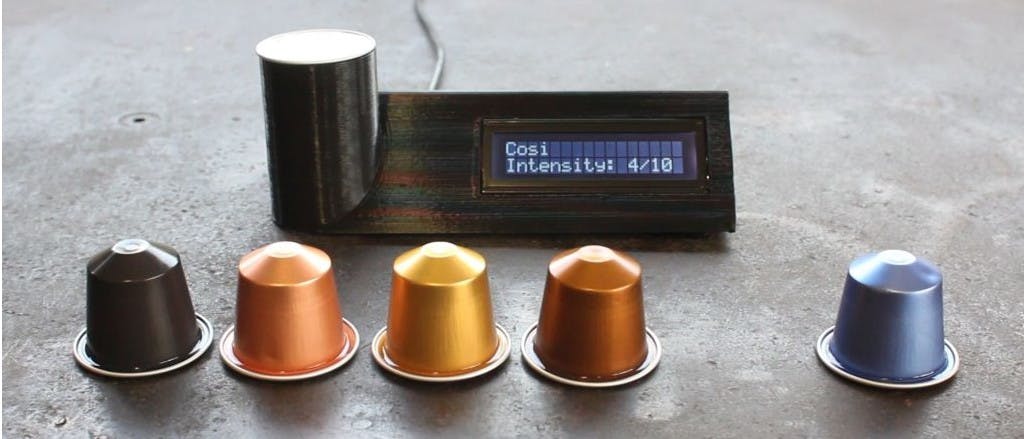

We hooked up our Arduino photocell to a system to control the opening and closing of our ‘sunflower’ but there are plenty of great alternative projects you could create using the same light metering photocells. You could create automatic lights that activated in low light conditions and switched off on their own during the daytime. This would be extremely useful for lights that are typically on throughout the night. Or, if you’re a morning person you could create a coffee maker that starts brewing first thing in the morning as soon as the rising sun triggers it. And while you’re at it, make sure you choose the right capsule with the coffee capsule detector.
Nespresso Capsule Detector
